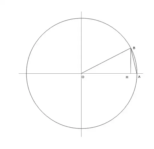

Answer (sorry for the crude drawing):
Let the angle $AOB$ on a unit circle be equal to $x$ (in radians), so the $BH$ will be $\sin x$ by definition. So, the area of the $AOB$ triangle will be exactly $\frac12 \sin x$ (since the base $OA=1$, and the height $BH=\sin x$). On the other side, the area of the $AOB$ circular sector is $\frac x2$. So, that means that we have to prove that the $AOB$ triangle has greater area than the AB segment (between the arc and the chord). (It follows from the fact that if $\sin x \geqslant \frac x2$, then $\frac12 \sin x \geqslant \frac x2 - \frac12 \sin x$ and vice versa.)
The $AOB$ triangle is isosceles (because $OA=OB=1$), and its height (not $BH$, but one originating from $O$) is $\cos\frac x2$ (since we can divide this triangle into 2 right-angled ones with one of the acute angles being $\frac x2$). So, the segment height is $1-\cos\frac x2$. That means that we have to prove that $\cos \frac x2 > 2(1-\cos\frac x2)$ (since the area of a segment is less than one of a rectangle with the same base and height).
But, when $0\leqslant x\leqslant \frac\pi2$, we have $\cos \frac x2 \geqslant \frac{\sqrt2}2>0.7$. Since $0.7>2(1-0.7)=0.6$ (and it's obvious that the inequality will hold for larger values of $\cos \frac x2$, which will make the left-hand side greater, and the right-hand side less), that's all. QED. enter image description here
trolley813
  • 11,282
  • 57
    The second part of your proof seems overly complicated. I would just draw tangents at A and B to get a triangle that covers the segment, and then show that triangle is smaller than OAB by comparing the base angles. – Jaap Scherphuis Sep 08 '21 at 07:39
