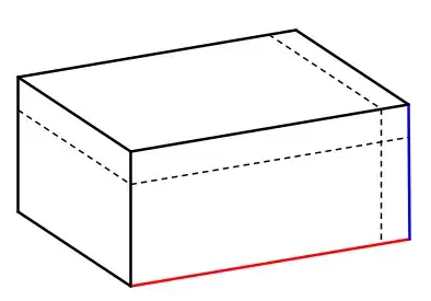

Answer:
Two cuts are required.
Reasoning:
One cut cannot be enough, a single straight cut can only cut a convex shape into at most two pieces.
Two cuts, parallel to the sides of the parallelepiped such that the red edge is subdivided as 9:1 and the blue edge is subdivided as 3:1, can cut the shape into four pieces with weights 1kg, 3kg, 9kg and 27kg as desired.
