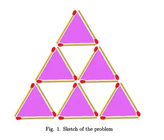

The puzzle is as follows [with minor copy edits for grammar]:
By only using matchsticks of equal length a set of equilateral triangles has been built as indicated in the figure from below. With that information, what is the minimum number of matchsticks that must be removed so that there aren't any of those triangles?
Sketch of the problem
The alternatives given are:
  1. 4
  2. 5
  3. 6
  4. 7
This seems to be a variation of the typical puzzle involving the construction of a certain figure, as the task here is to delete the triangles.
I tried all sorts of combinations in removing the matchsticks, and my answers keep being off by one.
Since I'm not very good at this, could someone show me with a way to solve this sort of puzzle without much fuss?
My first guess was to remove systematically all the sides, but this would require moving many matchsticks. Then I thought to remove only the critical ones.
This is a matter of several trials. Needless to say that I ended up removing more than what the alternatives say.
Perhaps someone with more experience than me at solving this sort of puzzle could provide a strategy on where to look for removals first?
As I mentioned removing the edges of the hexagon inside don't help much and removing the exterior matchsticks also don't help as it increases the number.
What's the trick here? It would help me if answers included a drawing so I could understand the necessary removals.
This was obtained from my Puzzle challenges book which from its looks seems to be an adaptation from an IQ test from APA exams of the 1980s.

@hexomino's answer is correct and well-reasoned, as always. Here's another approach, which to me feels much more.. "axe-to-the-head" is what I'd call it in my native language, so I thought it might be interesting enough to warrant posting.
Lower bound: (This is what @trolley813's encrypted comment is saying.)
At least six. Every highlighted triangle needs to lose a match.
Upper bound:
Six is enough. A triangle has three sides, no two of which are parallel with each other. If there are only matches in two orientations, then it's just plain impossible to create a triangle even by moving or adding matches.
So if we remove, say, all the six horizontal matches, we won't even have to look at the picture to know that there aren't going to be any surprise triangles lurking in the shadows anywhere.
Bass

I think the answer is
Reasoning
Note firstly that if we wish to destroy the triangles on the outside of the shape, we'll have to remove one match from each of these shapes. By removing the innermost match in each case we also destroy three more inner triangles thereby maximising the affect of this removal as shown in the image below.
After that, we see there are still three completed triangles in the middle. Since no two of these share a match, we are forced to remove three more matches to complete the task. This can be done in the following way,
As trolley813 mentions in the comments
6 is the lower limit here as there are 6 triangles with side length 1 which have no match in common (the triangles whose bases are horizontal) so we must, at least, remove one match from each of these.
hexomino
  • 135,910
  • 384
  • 563
    One small addition: rot13(Gur ybjre yvzvg vf 6, fvapr gurer ner 6 gevnatyrf (jvgu fvqr 1) juvpu qb abg unir nal pbzzba zngpurf, fb ng yrnfg bar zngpu cre gevnatyr unf gb or erzbirq.) – trolley813 Feb 24 '21 at 11:14
  • @trolley813 That's a good point, thanks. – hexomino Feb 24 '21 at 11:15
-2
Six again.
Explanation/Approach:
In this alternative set of solutions, you remove 3 alternate matches from the central wheel, and then one each from the corner (small) triangles while making sure that at least one of them is from the outer boundary (else, the big triangle formed by the outer boundary remains). An example solution from this set is: enter image description here
