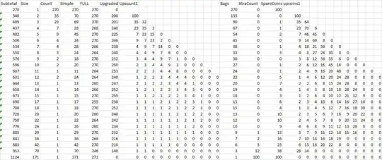

I put together a spreadsheet which
starts from the smallest bag sizes, and calculates for each larger bag size how many bags can actually be taken using the budget of 100 extra coins to top up the next-smallest bags, and gives a FULL total of how much the knight will get using the obvious bag-filling strategy (keep filling the next-largest bag until you've not got enough coins, then if possible split any remaining coins evenly between the bags you're taking).
In the final configuration shown above, it looks like this:
Spreadsheet
Some explanation:
"Simple" is just how many coins there are in the bags of the specified size.
"FULL" is the total amount the knight can take, comprising Simple, Upgraded, and Bags x XtraCount
"Upgraded" is the total coins in bags that have had coins added.
"Upcount1" is the number of bags of the next-smallest size that have had coins added, which is then multiplied by the difference in bag size to get "upcoins1".
Next 9 columns are implied as "Upcount2" to "Upcount10", which was as many as I needed.
"Bags" is the total of the number bags of that size, plus all the bags that could be upgraded by adding coins.
"SpareCoins" is the number of coins left over from the 100 after upgrading as many bags as possible.
"XtraCount" divides "SpareCoins" evenly into the "Bags".
The spreadsheet can also automatically calculate
"Count" based on how many coins are spare taking into account "Upgraded" for the next proposed coin size, and the maximum value of FULL encountered so far. This was useful for the first solutions, but for the later ones, I found that manually tweaking was easier, especially given that it doesn't take SpareCoins into account (which were added later). When I referred to "wiggle room" it's the ability to slightly change some of the numbers in Size and Count columns whilst still keeping the FULL column within the currently-chosen limit.
One important point not directly known by the spreadsheet is that
The second-largest bag should be at least 101 coins smaller than the largest, so that the knight cannot take both.
