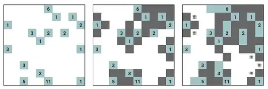

So, time to solve a Nurikabe from the teal numbers!
(1) The initial puzzle.
(2) Some basic deductions just from 1 rooms, adjacent clues, and shaded cell connectivity.
(3) Some more deductions, extending the rooms. (Some cells have been marked for the next step.)
(4) Look at all the cells marked with "!!!". Each of these has only one room that can reach them -- and if it does, it cuts off some of the shaded cells. (5) Next look at the 2x2 region of undetermined cells near the top. Either the top two there or the bottom two must be shaded; if the bottom two are, the 6 cannot extend left enough to prevent a 2x2 of shaded cells in the upper left.
(6) The top-right undetermined cell is impossible to reach, so it must be shaded. Then, the 3s must extend upwards to reach the two cells next to it, and the puzzle is solved. enter image description here
