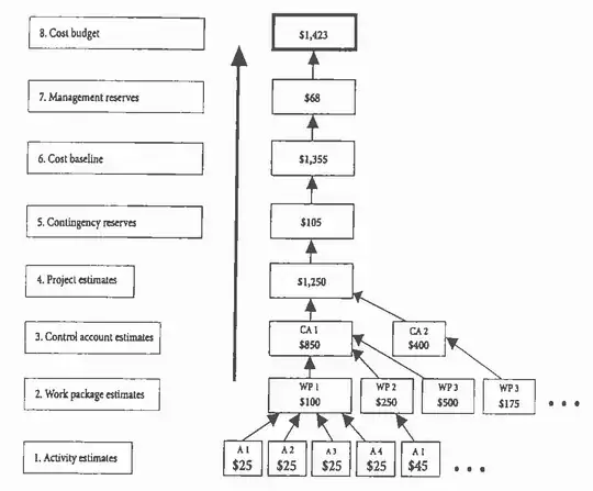

What is "intermediate buffer"? What is "overall margin at the end of the project"? There is no such thing as "margin" for a work package.
The terms used in the question indicate that padding is used, which is a problem. In order to avoid padding and keep your schedule/cost realistic you should do risk management. Identify and document all negative and positive (!) events, which, if they occur, may change cost and/or duration of your work package. Estimate probability and impact of these events. Manipulate them all together outside of your work package. All together they will affect your contingency reserves:
Picture is taken from Rita's Course, 6th Ed, page 238.

yegor256
  • 7,050
  • 50
  • 'intermediate buffer' = a buffer somewhere in the middle of the schedule, to allow for risk and dependencies; "overall margin" = a buffer between the expected end-date and the committed end-date. I don't HIDE the buffers, on the contrary, I make them explicit! I'm afraid your interpretation is wrong. – Stephan Mar 09 '11 at 15:12
  • You shouldn't have any buffers in your schedule/cost. It's PMBOK's interpretation, not my personal. – yegor256 Mar 09 '11 at 16:53
  • As long as contigency buffers are "clearly identified in schedule documentation", PMBOK doesn't care. Besides, Critical Chain is one of the scheduling techniques described, which is based on adding buffers to manage uncertainty. I do something similar, scheduling with most likely estimates, adding buffers where schedule risk is high. – Stephan Mar 09 '11 at 22:13
    There are no buffers in Schedule, according to PMBOK (If I'm mistaken please give a page number inside PMBOK). "Adding buffers to manage uncertainty" is called padding and shall be totally avoided in project management. – yegor256 Mar 10 '11 at 08:20
  • I am afraid we misunderstand each other. "Padding" is adding a buffer to individual estimates, but representing it as one figure. Hiding the buffer, in fact. I don't hide anything. On the contrary, because I work with a range of estimates, instead of a single point estimate, I cut out the possible 'padding' from the lower (most likely) estimate. Any buffer I calculate is presented apart from my estimate and is a separate budget. By the way, I you can give me the page number where "padding" is explained in PMBOK, I would be much obliged. – Stephan Mar 11 '11 at 08:28
  • @Stephan I updated my answer with a quotation from Rita's Course 6th Ed. Hope that helps. – yegor256 Mar 11 '11 at 10:45
