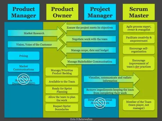

The Project Management role grew from needs to coordinate in the traditional environments. If the title sticks around, the role still has to change. I've seen PMs take on higher level coordination, become a PO, become a SM or design a new role altogether. This is all depending on your organization, quality of agile adoption and access to coaching. If not thought put carefully you can create duplicated work and unnecessary role confusion.
A year ago I put together a graphic to help some other PMPs with the discussion. Maybe it will also bring you some clarity. This in no way is an exhaustive list or view, just an illustration of how some responsibilities might shift and the importance of understanding how people share roles.
Blog Post - Moving Away From Titles or "What Happens to to Project Managers in an Agile Transition"

    Nice graph. It sure is adapted to the current situation. However, I think you should take release manager into a consideration also. From my experience, I've seen project manager becoming Product owner AND release manager in a smaller organisation. – JustinBieber Jun 10 '13 at 19:56
  • Thanks. That is why I said it is not exhaustive and is meant to give you an idea of how you meant think out the specifics in your business. I suggest your make your own and share it with others to see if you can get a shared understanding. – Erin Beierwaltes Jun 11 '13 at 21:07
  • Link has expired archived link at https://web.archive.org/web/20120611060829/http://www.skipstoneconsulting.com/index.php/blog/8-blog/2-moving-away-from-titles – Geoff Burns Jun 08 '20 at 04:38
