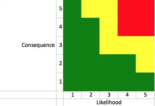

  • Risk severity and probability: often these are characterized in a five-by-five, color-coded matrix, where the y-axis represents the likelihood of the risk occurring (1 = highly unlikely, 5 = almost certain) and the x-axis represents the consequence if the risk were to occur (1 = not that bad, 5 = devastating). Often, consequence is assessed against the metrics of cost, schedule and technical (i.e. performance), with the worst rating across all three categories being the one that is assigned. The colors indicate the seriousness of the risk. Your risk database should have objective criteria defined for each level of likelihood and consequence. A helpful comment points out some mathematical rigor can be put behind how the colors are assigned in this matrix. A good synopsis of the canonical paper proves many standard matrices (like the one from NASA below) are misleading.
standard risk matrix Image credit NASA
A colored 5 × 5 matrix consistent with the findings of this paper would look more like this:
better risk matrix
