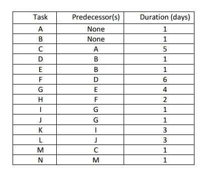

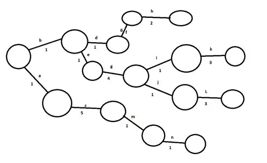

I'm studying for a software engineering final that covers project management, and am having a little bit of trouble with actually drawing network diagrams. The problem is, I've followed the table below and drawn a network diagram, but every example I've seen online, everything always converges into one final node.
Source Table
Data Table
My Diagram
Diagram
Note: I haven't added numbers to nodes.
Assuming the diagram's actually correct, I'm guessing the critical path is just the branch it would take the longest amount of time to traverse?

I hope this will help, I am currently studying these things as well; so, for what it's worth, this is what I can derive from speaking with PMPs I know and reading the PMBOK.
The critical path is a path generated by Finish-to-Start dependencies from one task to the next - resulting in a happy-path (everything went right) minimum project duration. So, if we assume all the tasks in the table and their predecessors are Finish-to-Start you seem good in drawing your chart.
Now, given that a project is defined as having a defined beginning and end, we could add a "virtual" node/task - wrapping up the project which has a Finish-to-Start dependency with the "final" node(s), with the path of the longest duration (as you may find your example has multiple paths resulting in the same total duration), in your diagram. So, if any of the tasks on those path(s) take longer than estimated - the further out our final node gets - critical path(s). For paths in your diagram that are shorter than the longest duration, there is an assumed Finish-to-Finish relationship from the final task on that path to the final "virtual" node in your diagram - because the project can't finish until all nodes/tasks are complete, but we have wiggle room for them to take longer than estimated (task M, for example) without effecting the total project duration.
In a nutshell, just as there is no task "0" for the first node in your graph - it is assumed to be the impetus for all other nodes - there is a node "n + 1" at the end of the project, which is where we tie a bow around the project. In the case of software engineering this might be the beginning of a new project - "Finish development - Begin preparing for marketing and release"...it's just not explicitly named in the data set.

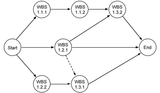

In common usage, an activity-on-node diagram is generally expected to define real or virtual nodes for the starting and ending states. These nodes often represent project initiation and project closing, but integration or delivery (or even other terminal activities) might be the right endpoints for certain diagrams. In any case, you can certainly add "start" and "end" nodes when needed. For example:
Activity-on-Node Diagram with Start and End Points
However, if used as an activity diagram with multiple end points and parallel or near-critical paths, you can still use CPM to measure the longest distance between any two nodes in the diagram, so it's not inherently necessary that all paths converge.

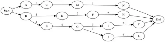

Programming the Answer
Diagramming the Recommended Solution
Given your input data, and given my recommendations above, I'd suggest the following solution using Graphviz. Most people can skip this section of the answer, but it's here to document how to create such a graph by mapping the tasks and predecessors from the source table into code, which then generates your critical path diagram.
DOT Input File
The following contents should be stored in a DOT file named cpm.dot for compatibility with the subsequent examples.
digraph cpm {
    // predecessor -> task [label=duration]
    A -> C [label="5"];
    B -> D [label="1"];
    B -> E [label="1"];
    D -> F [label="6"];
    E -> G [label="4"];
    F -> H [label="2"];
    G -> I [label="1"];
    G -> J [label="1"];
    I -> K [label="3"];
    J -> L [label="3"];
    C -> M [label="1"];
    M -> N [label="1"];
    // virtual start & end nodes
    Start -> A, B;
    H, K, L, N -> End;
Create Graph from Input File
Generate cpm.png from the DOT file using Graphviz:
Resulting Activity-on-Node Digraph
Recommended Critical Path Diagram
