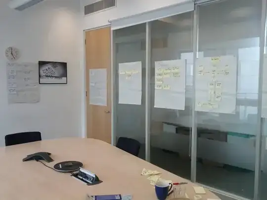

I've tackled this previously by using a session similar to your early requirements workshop to break the work up into reasonably large epics (usually workflow steps from a customer perspective).
We'll then estimate those chunks in weeks of effort giving a ranged estimate and noting any assumptions we're making. Where the range given by the team is large we'll drill further into risks to try and uncover where the uncertainty lies.
The total range as well as the assumptions and risks can then be presented back to the committee. If there is too much uncertainty (the range is too big) for them to commit to the project, you can then ask for time to investigate some of the risks and assumptions to see if you can get some more certainty.
This lets you get an up front cost estimate and makes it really clear to all involved what (foreseeable) things will affect that cost without going to the level of creating all your stories up front or having to convert from points to hours.
Here is the output of similar sessions my team did a while ago:
