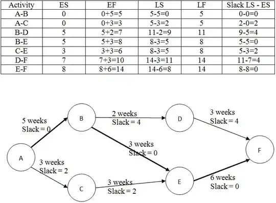

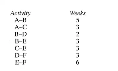

Can you please tell me how can I use the slack value in my network diagram to readjust it(if it is applicable)? Using the following table, I have calculated the slack value and drawn a network diagram. enter image description here
Finding Slack Value: enter image description here
A->B->E->F = 14 weeks is the critical path
A->B->D->F = 10 weeks
A->C->E->F = 12 weeks
I want to keep the original project duration intact(therefore, I am not going to change the number of weeks used in the critical path). But I want to reduce the number of weeks used in non critical paths. Can I do that by using the slack values(or another method)?

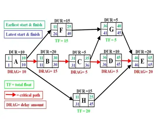

A Better Model for Slack with Critical Path
According to Wikipedia's entry on the critical path method:
Although the activity-on-arrow diagram ("PERT Chart") is still used in a few places, it has generally been superseded by the activity-on-node diagram, where each activity is shown as a box or node and the arrows represent the logical relationships going from predecessor to successor as shown here in the "Activity-on-node diagram".
The benefit of this model over the one in your question is that it allows you to model variance on the critical path, which is something that your sample currently does not provide. It may therefore be worth re-evaluating what you're trying to model, and whether activity-on-node will provide a better planning tool for your specific use case.
I am reading this as you want the total duration of your non critical path network to decrease thus increasing slack on those paths. To do this, all you need to do is decrease the target duration of those packages that are off the critical path.
However, I am not sure what the value is in doing this. The initial assumption is that, within the probabilistic distribution of duration of each of your packages, you are targeting a duration that is somewhere around the MODE of that distribution, a target that represents a realistic possibility but also lean enough to not constitute over buffering. When you reduce that duration, you are increasing risk and, in order to mitigate, you end up increasing resource utilization and / work hours in order to meet the more aggressive target duration. Duration = Work / Resource Utilization.
This then threatens work activity on those packages on the critical path, which will directly threaten your overall duration.
Of course, on the other side of that, you are increasing your slack so you have some cycles in there to cope with unfavorable schedule variances. However, all this looks super on paper, but your reality will be very different.
Your other risk is, your critical path at planning is valid only at planning. At the moment you press go and begin work and begin progressing your packages in the schedule, your critical path(s) WILL change and change and change and change. Those packages that you arbitrarily reduced duration can and will likely fall in the new critical path(s) and, since you reduced the duration and increased your threat, you have now created a bigger threat to your overall schedule duration.
All in all, I cannot see the logic in what you are attempting to do from a scheduling / planning perspective. That does not mean there is no logic, I just cannot see it and I have never heard anyone discuss this before.
