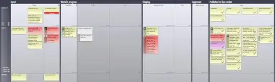

As for myself it is a known dilemma and in our company we took approach in merging utility/recurring tasks in our main Kanban process pipeline where we have two separate rows. One is for the main flow of the items and the second one is for recurring small tasks (it does not counterfeit with Kanban itself, it is just a two layer process). The WIP limits are calculated per column for both rows.
Such board example using Eylean board tool for Kanban enter image description here
Yet, as CodeGnome said, it is not a day planner so you should add only tasks which are related to the production and they have final value for your goals. Kanban is strongly against the waste, so you should not litter on your board with such tasks as "Meeting" or similar. Try keeping those away. If you are doing Kanban, you should do it on your production, not your daily routines.
