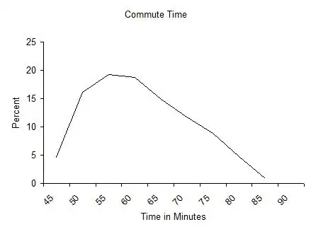

Aclear16, on an answer from another question, brought up the notion of accuracy of estimates. In my view, this notion is nonsensical; however, we talk about this often in PM circles.
In an estimating training class I taught, I wanted to demonstrate the effects of random variability on projects, results that occur secondary to the plethora of variables over which we have little to no control. To do this, I literally, with a time watch, tracked my time from door to door, coming and going, my commute to and from work for over a year. I plotted the results:
(Yes, I hate my commute.)
So, if a commute was a project and I was wanting to target accurately, with this historical data as input to our estimating exercise, where does accuracy live?
If I choose "65" minutes, a slightly more pessimistic target over the MODE, and I arrived at 75, is my estimate "not accurate"? Conversely, if I plan at "80" and arrive in "50", is that also not accurate?
So here's the ultimate question: what does an accurate estimate mean?
(This is question that really does not have an answer and likely violates the rules; however, I hope we can entertain this as I think it is valuable to understanding a very important process in project management. I am hoping some good critical thought and discussion will ensue. Thanks to aclear16 for triggering this!)

    Is there a danger or penalty in providing, or targeting, the longest lead time, e.g., 87 minutes in this example? – David Espina Aug 25 '12 at 22:59
    Continually targeting the longest lead time encourages your team to never push themselves, probably increases your costs, and is generally not a good idea. I believe it is as detrimental as continually choosing the shortest lead time. Extremes are usually not good targets. – Andrew Clear Aug 26 '12 at 04:35
  • @aclear16 for me, continuous improvement comes first - with the culture - and its result is reflected in the estimation. – Zsolt Aug 26 '12 at 06:38
  • @DavidEspina the danger I'm aware of is losing market. If I go with 87 and the competition offers 67 for example, people will go for the 67. Even if the 67 version gets postponed several times they'll stick to it (they won't give up their investment) and won't come for my 87. If I give 66 I put my company in risk, because I have to self fund the additional effort caused by the 87-66. And we got to the risk management topic. – Zsolt Aug 26 '12 at 06:47
  • @Zsolt: Can you clarify what you mean by "continuous improvement comes first?" How, if at all, are you fostering this by choosing the longest lead time? Also, are you referring to continuous improvement of your personnel, or continuous improvement to your project? – Andrew Clear Aug 27 '12 at 17:58

  • So is it about your target being accurate / precise or is about your ability to predict the future? Most of the variability in performance we experience is random and uncontrollable. Do you disagree? – David Espina Aug 27 '12 at 14:49
  • The issues of variability of performance and precision of estimates are related. My point is that accuracy and precision are different and having excessive precision in one's estimates may not add value. Trivial example - For sales tax of 12% on a purchase of $1.99 a precision beyond two decimal places has no value, so final price is $1.23 rather than the (precise and "correct") $1.2288. Likewise, if my estimates have an error of weeks why give a target date rather than a target week/month? – Doug B Aug 27 '12 at 18:03
