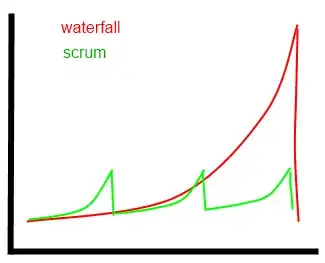

When I took a scrum class, the instructor showed a graph similar to this one.
Comparing Level of Effort
This is a chart of the amount of effort exerted by developers in a classic waterfall project vs the amount of effort exerted by the developers on a scrum/sprint-based project. The idea is that by creating a lot of little deadlines, it increases the effort exerted on the project for each sprint deadline rather than waiting until the very end of the project when people start realizing THE deadline is coming and they start working crazy hours for weeks on end.
