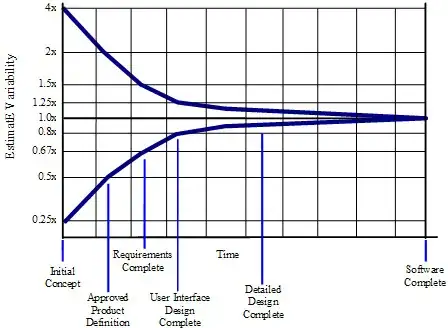

Read about Cone of Uncertainty - the longer you work with the project the more accurate and precise is your estimate of its duration and size (image from Construx.com website):
construx image of CoU
PMBOK suggests to re-estimate the project every time you have more information about its scope. You start a project with ROM (Rough order of magnitude) estimate and refine it at every milestone. I would also suggest to read Steve McConnel's "Software Estimation: Demistifying the Black Art" - it gives a good summary of existing estimating techniques.
