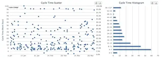

This is a tough situation I admit. In a situation like this I would try to say which is the latest situation when I'll be ready with something. You are working in an IT environment so I assume you have similar activities so you can measure how much time you need. Here is an example by Larry Maccherone:
Here you can see how much time his team needed to finish something. You can read the diagram like this:
If you have a tough week your cycle time increases accordingly you can say you manager that you'll 32 days to finish, but during a calmer period you'll need about 12 days. You must emphasize that it is just a plan, not a full commitment. I think your manager will understand it.
There's also a screencast, you may find it useful.

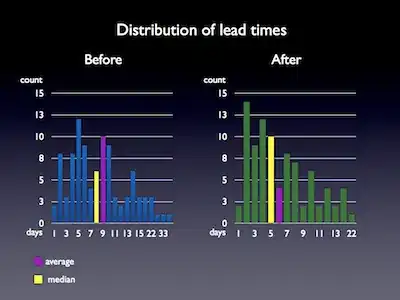

Several month ago my former team had to give an estimation to sales about the possible date of certain deliveries. We were using lead time distribution in order to answer his question (my slides about it are available here):
Before, we had no idea what to say, so we gave him the lead time 9 because it was our average, sort of say. Then we learnt more and measured a lot so we told him that we would need maximum 5 days to deliver a new request. Maximum means that it is either 1,2,3,4 or 5, but nothing above (+1, we were using median because it was more accurate than average). And it worked pretty well.

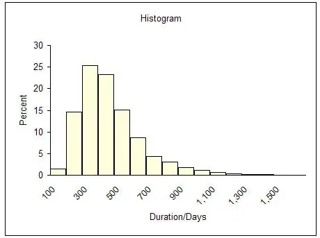

If you really want to get sophisticated, you can add to this problem your probabilistic utilization distribution, too, meaning you will be dedicated to the project from 4% to 20%, most likley 12%. Run a simulation between that and your hours distribution and see what happens to duration from a pure random perspective. Then, you can base your duration plan on that result and on how risk averse you are.
Here is a sample simulation results using the numbers above:
This suggests your project will run anywhere from 150 days to as high as several years, but your MODE, your highest probability is 300 days. So set your target somewhere there.
This is a rather extreme example so the results are a bit comical, but hopefully you can see how it works.
