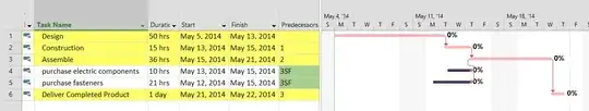

Start-to-Finish relationship is used to schedule the timing of the successor task. i.e when task B should start so that to finish with the start of task A.
For example: in this project, critical tasks are design, construction, assemble and deliver. But there are 2 non-critical tasks that need to be "ready" exactly on the day when the assembly task starts; those 2 tasks are (purchasing electric components and purchase fasteners).
Those 2 tasks should be scheduled to start early enough, so that to finish (and be ready) on the day assembly starts - not sooner or later.
Purchasing tasks should not finish too early, so that not to waste resources on inventory costs to store those components, but also those components should not arrive too late, because they are needed for the assembly. So the purchasing those components should finish just the day construction starts.
The Purpose of this type of dependency: is to schedule tasks in order to finish relative to the start of the predecessor task.
In this example, purchase electric components: should start on May 13th in order to finish on May 15th purchase fasteners: should start on May 12th in order to finish on May 15th
On the timeline: The pink tasks are critical tasks, while the two dark tasks are non-critical, and their dependency on the task "Assemble" is defined as Start-to-Finish, as shown.
Purchasing tasks should Finish-to-start construction task
Sam Bad
  • upvoted because of the screenshot/diagram of how this actually looks like with a good example –  Feb 17 '17 at 16:11
