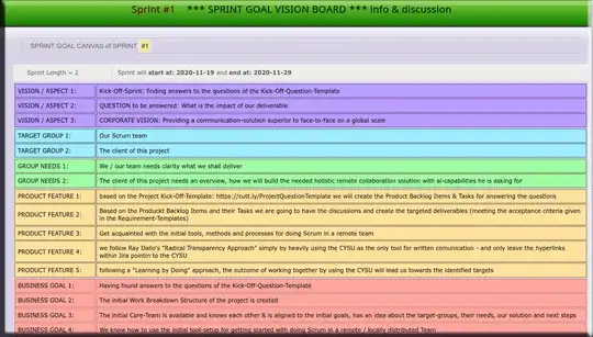

Within a Scrum team, coming up with the requirements is usually part of the Product Owner's job - he or she represents the customer and its needs, desires, problems - and how "we as a team" shall address them and deliver a product (and within Scrum, we usually focus on the Sprint and its deliverables / the Increment) for meeting them.
Therefore I as a Product Owner (who is using the CYSU remote Scrum application with integrated requirements-engineering & CFLX-enhanced discussion-threads, btw) start with a "Sprint Vision Board" (analog to a "Product Vision Board") in which I make exact these filling for every single Sprint for bringing in more context for a better understanding about the real requirements, about the "why"... ... and I do add the "HOW" and with which "Acceptance Criteria" / requirements additionally to the User-Story to the PBIs (using modifiable dropdown-elements for gaining productivity and stick with the wording, btw...) And of course: This is a process which is performed within a participative approach! ... good discussion is the key. ... or even: context-enriched discussion for a better understanding / for better guesses about the meaning / more hits related to the interpretation is the way for better collaboration and better results, motivation, understanding of the big-picture...
below two screenshots (1x the vision-board; 1x using the requirement template ... just realized it's an older screenshot, today the two templates are for declarative and procedural requirements. functional/nonfunctional makes no sense from a writing perspective..)
here's the link to the CYSU for doing remote Scrum, btw: https://sourceforge.net/projects/cybr/ (running on docker / docker-compose, just follow the steps in the readme..) sprint goal vision board for more context requirements template dropdown elements
the link to the CYBR-SUITE (CYSU) remote Scrum App at Sourceforge: https://sourceforge.net/projects/cybr/
You can ask me for help if you need to (I do have additional documentation, presentations, videos...) DISCLAIMER: it's my own project...
