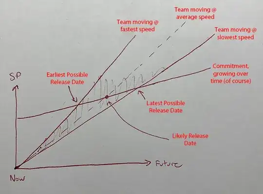

A good rule of thumb is to drop the highest and lowest numbers and average the remaining. In your case you'd drop the 5 and one of the 16s and get a smoothed average velocity of 11.75, meaning you'll complete 150 more story points in about 13 more sprints.
While the average is useful, I'd highly recommend communicating projections to your product owner in a graph instead.
First, draw 3 lines from the origin point showing projections of your team's progress, one with your team always moving at its slowest (5 velocity), one with the average, and one with the team always moving at its fastest speed (16).
Then, draw a line from (x=0, y=current backlog commitment) showing the change in the commitment over time. Since POs tend to want to add things and devs tend to find new wrinkles in the project, this line generally trends upward.
Now you've got some lines that (hopefully) intersect which demonstrate the earliest possible, likely, and latest possible completion times for the release.
