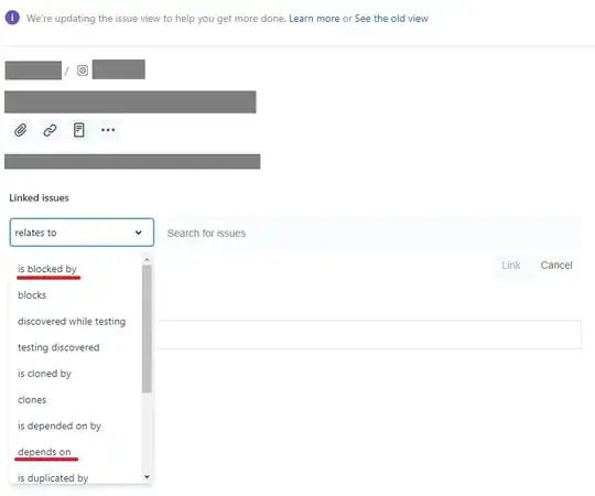

In Jira, (probably) in next-gen board, when specifying relationship between two issues, I have the following choices:
-- i.e. specifically "[A] depends on [B]" and "[A] is blocked by [B]".
What is the difference? Does "is blocked by" imply some stronger kind of dependency? Or are meanings of these items just project-dependent (i.e. no universal guideline)?

Jira links are broadly used, as far as I can see, for an information-only purpose.
All in all, it boils down to how your team uses it.
With that in mind, it'll strongly depend on what is considered a "dependency" and a "blocker" in your context.
Given the following scenario:
foo depends on bar
foo is blocked by baz
One way of reading it is as:
  • Foo cannot be started until bar is completed
  • Foo was started but baz happened (an external factor, probably) and it's blocking it's progress
Which could be derived into:
  • Depends are used for known or planned activities
  • Blocks are used for unexpected activities

I have always looked at them in the following manner: Depends On indicates a relation and order of a task to another, and Blocked By is a task progress status.

Though being a blocker or a dependency are colloquially similar, Jira Roadmap timeline view can treat them differently. By default:
"blocks"/"is blocked by" is the link type required for the Roadmap view to show issues as linked in the Gantt-style timeline view. If you manually/visually link issues within the Roadmap timeline view by clicking the link handle from one issue to another, it creates a link of this "blocks" type.
"depends on"/"is a dependency of" links are not reflected in the Roadmap timeline chart, nor are they the link type created when manually as described above for "blocks" link types.
This distinction is configurable for Advanced Roadmaps by a Jira administrator. It may be configurable for links in regular roadmaps, though the documentation is a little less clear about that.

Dependencies and blockers are the same thing. The difference in tag typically means whether the event was planned for or not, whether it presents an unusual problem to be solved, whether it is escalated for different sets of eyes and/or hands, and possibly which bucket of dollars is being used to work it.
