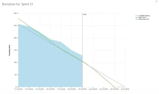

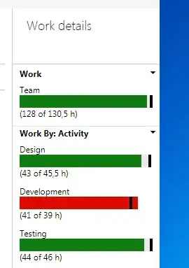

I do not understand why the burndown is looking like it is. Remaining work is higher than capacity - but in the details remaining work is lower than remaining capacity.
Can anyone help?
Burndown
Work details

  • The burndown chart gets updated at the end of the day, the work details are updated as and when the 'Remaining Hours' in a task is updated. – Shaunak Lawande Feb 25 '20 at 07:37
  • Minor deviations are expected in such charts, which are just "early warning systems." If you aren't on track to meet the Sprint Goal, then it's worth discussing with the team whether work will burn down faster later in the Sprint or if scope or Sprint Backlog items needs to be renegotiated to re-align with capacity and rate of progress towards the Sprint Goal. – Todd A. Jacobs Oct 18 '23 at 16:01

I'm not sure where this data is coming from, so this is only an educated guess. However, it looks like your burn-down is correctly showing that you have more development work than originally planned. Depending on your system, this can happen if:
  • New work is discovered during the iteration, and added to the Sprint Backlog.
  • You're tracking hours spent rather than tasks/stories done, and hours spent exceed the original estimate.
In this case, it looks like the latter. Your team estimated 39 hours for "development" (whatever that means to them), but has expended 41 hours on those activities so far.

I believe that the discrepancy you are seeing is caused by the two figures using different figures for capacity. This is just an educated guess but it looks as though the work details tab is using capacity at the start of the day, while the chart is using capacity at the end of the day.
If I'm correct, you can interpret the figures as follows.
From the chart: At the end of today there will be a little over 100h of capacity remaining. Right now there is somewhere between 120-130h of work to be done.
From the table: At the beginning of today there were 128h of work remaining in the sprint. At the beginning of today there were 130.5 man-hours available to do work.
either way there isn't a whole lot of slack...

While looking at the graph I noticed that the sprint lasts longer than you have capacity available. Are the values for sprint length and capacity set correctly?
