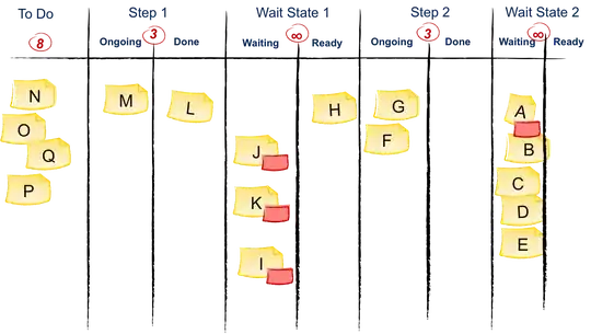

It looks like you have a process for doing your work that has intermediate stages where other people need to work on each work-item or card. And you have no control over how long they might take to get them done.
This is typical of a "multi-team" Kanban boards where intermediate wait states between teams can take too long and essentially behave like infinite queues.
As Todd said above, all you can do is ensure you have a Kanan board that visualizes your process and work - and helps highlights where the bottlenecks - something like the one below -

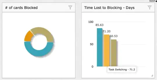

At the same time, using a Kanban lool or even a spreadsheet, you can get some additional analysis done to see the patterns of your hold-ups - like who or which team/ type of work is causing the most delays, amount of time lost to different wait stages, and it's root cause analysis which could be captured based on some standard reason codes being captured, etc. You can treat the cards as 'blocked cards' for example and an analysis such as the one that our tool SwiftKanban provides -
The idea of using Kanban is to visualize the bottlenecks and get everyone involved in helping you resolve them.
