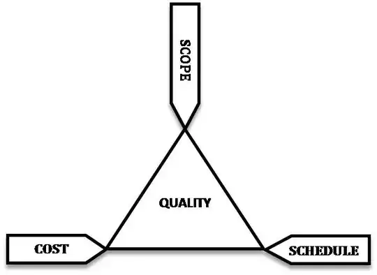

Trade-Offs
The project management triangle is generally understood to be a set of sliders consisting of scope, schedule, and cost. (NB: There are other models, but this one is the most common.)
Project Management Triangle
The point of this metaphor is that you manage quality by adjusting the sliders, but they're interdependent. You can't fix cost, schedule, and scope at the same time, so increased scope will generally increase a project's costs and schedule as well, while often reducing overall quality as the organization attempts to increase scope without increasing costs or extending the schedule.
As a project manager, you need to be able to articulate the trade-offs for the project. In your specific case, you need to have a deeper understanding of how those trade-offs are made within an agile context, and what tools your framework provides for managing and communicating about those trades-offs.

  • Good answer except the last image. Especially the word "quality" in the middle is problematic. The point of scope, cost and release date / schedule / deadline triangle is that you cannot focus on all the three vertices at the same time but have to select a single point inside that triangle instead to reflect weight of all vertices. I think it would make more sense to have a triangle with vertices "low cost", "quick release" and "scope/complexity" and you have to select a single point inside the triangle to reflect what you want. In addition, I would put the labels on edges instead of vertices. – Mikko Rantalainen Oct 11 '21 at 09:40
  • If you have label (e.g. "Low cost") on the edge of triangle instead of vertex you get the obvious result that with low cost you can either have a quick release or low complexity. With labels in the vertices it's often harder to understand that you can select 100% of two at the same time. – Mikko Rantalainen Oct 11 '21 at 09:43
  • In my experience the most problematic part is if (hopefully small?) feature creep is required during a single sprint (or whatever the respective feature in your agile methodology is). If you take SCRUM as a religion, every decision will have minimum delay of the length of a single sprint because you cannot adjust the sprint goals. You have to use some kind of unorthodox version of SCRUM to handle quicker changes in requirements. – Mikko Rantalainen Oct 11 '21 at 09:49
  • Perhaps the most impactfully problematic aspect of the PM triangle, most management paradigms really, is the disrespect of treating Quality as an outcome/result and not a primary focus. – Alan Larimer Nov 28 '22 at 03:43
