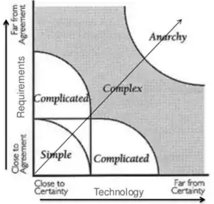

You might be able to make a case that predictive processes or methodologies can be overlayed onto more simple or even complicated projects; however, most software development is definitely in the complex range. For further reference, check out the Cynefin Framework for good definitions of simple, complicated, complex, and chaotic.
