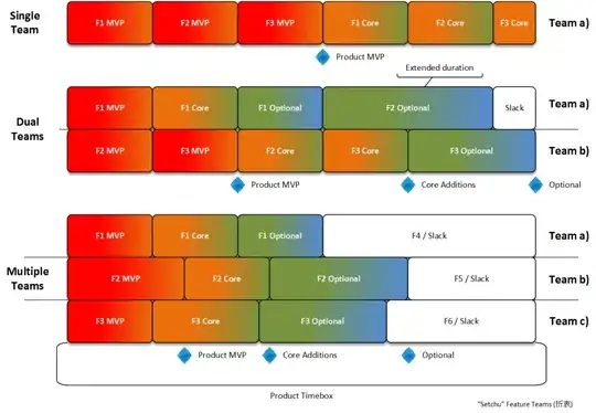

Alternatively, you may be able to demonstrate that if they allowed more time / resources / teams, you'd be able to deliver more of what they want:
MVP-oriented feature teams
Source: http://agile-setchu.org/setchu-guide/agile-feature-teams/
