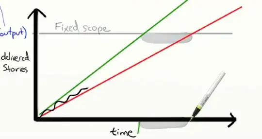

You can plot your teams velocity against the backlog and get optimistic and pessimistic release dates.enter image description here
The wavy black line is your team's burn-up line - it fluctuates because velocity often fluctuates. The green line is an estimate of their best burn-up/velocity and red is an estimate of their worst burn-up/velocity. Where they intersect the fixed scope line provides an estimation of the release date. A video explaining this is here.
