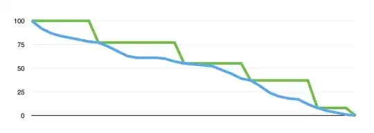

Why not base the burndown chart on both?
It has the benefits to show you some insights about what's happening concerning your tasks (so it clearly shows the actual effort) without putting it out of the context of the stories (as it puts the value on top of it).
The most interesting point seems to be that it shows the relationship between effort and value: for instance, on this chart the first two stories show a rapid beginning and then some pain towards the end. Even a plateau in the effort can be found in the second story. On the other hand, the third story shows some pain in the beginning but then it shows a rapid completion in the end.
Matter to discuss for the end-of-sprint meeting. How can we improve this? What does that mean? On the long run, do stories which begin rapidly tend to be painful in the end? etc.

  • I like the pragmatism! Your suggestion of doing both will probably be of use to some teams. Our team has found that focusing on finished usable products is way more important than feeling good about partial progress. We've therefore decided to keep the burndown at story level. You're very right about the role of the retrospective in all this. We've had two retrospectives since, both giving a lot of insights into the root cause of the issue, and how to improve in the future. – upstream Aug 24 '15 at 14:13
