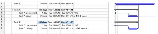

If I understand the problem correctly, my solution would be to split task A into 2 components: Procurement and Delivery. Procurement would have a short duration - in the illustration below I have given it 1 day - while delivery would be 2 months, representing the time taken for the supplier to deliver the component. By creating a Start - Start relationship between Task B and Task A Procurement, you show the start dates being aligned. By then creating a Finish - Finish relationship with 4 months gap, you can force Task A Delivery to finish 4 months before Task B finishes. You could also show it another way, using a Start - Finish relationship between Task B and Task A Delivery... I have shown this on the example below as Task C.
Does that address the problem?

  • I think the second method is closer to what I’m looking for because it directly encodes the 5-month span (rather than the 4-month duration from when A and B are completed. In this case 5 months is the actual constraint: some furnished piece of hardware is required 5-months after authority to proceed. This method seems to show the bars in the right place. I'd need to experiment and see if they move as expected if durations change. – Adam Wuerl Jun 17 '15 at 03:50
