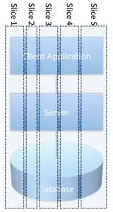

  • The other problem is that we are not cross-functional. We have client developers and server developers. Oftentimes even with a thin vertical slice, it takes the majority of the sprint to deliver the new service for client consumption which doesn't leave much time for integration and QA and we cannot call anything done-done – Sinaesthetic Apr 23 '15 at 23:27
  • Also, it seems that the article from which that diagram was taken had some other comments (http://blogs.adobe.com/agile/2013/09/27/splitting-stories-into-small-vertical-slices/) about those slices actually being meaningful. Perhaps there is still a place for horizontal slices... – Sinaesthetic Apr 23 '15 at 23:49

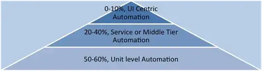

All stories that adhere to the INVEST criteria are inherently testable. In my personal experience, stories should generally be driven by feature or integration tests, and tasks should be driven by unit tests. There are certainly all kinds of caveats and exceptions to this rule of thumb, but following this advice helps in many ways, including:
  1. Feature tests (such as automated browser testing) show the feature from a user-visible point of view, and may even stand in for user acceptance testing in many situations.
  2. Feature tests build trust with stakeholders, and often demonstrate that the Right Thing™ was built.
  3. Unit tests are for the Development Team, and help drive design and prevent regressions. They are generally uninteresting as Sprint Review demonstrations, but are the most important items from a sustainable development point of view.
  4. This style splitting TDD and ATDD along the lines of features vs. tasks helps maintain the testing pyramid, with a few slow high-level tests supported by a base layer of blazingly-fast unit tests. For example:
    Test Pyramid from Velocity Partners
As always, there will be exceptions and caveats, but as rules of thumb I have found the foregoing to be reasonably solid practices. YMMV.
