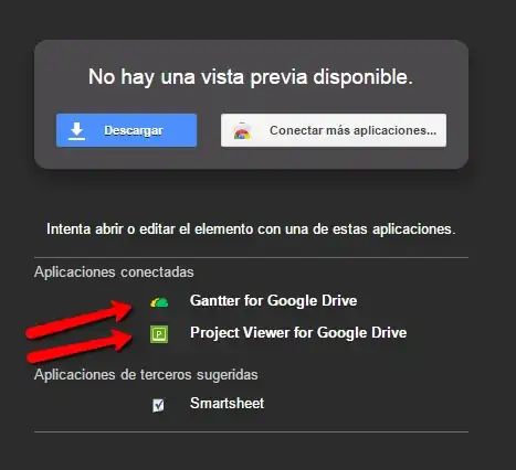

Other possible solution would be to upload your MS Project file to google drive. Once there, try to open it and a popup will display asking you to use a couple of free tools: 1. Gantter for google drive 2. Project viewer for google drive
Then, I guess you can share the file with your team.
Take a look at my screen

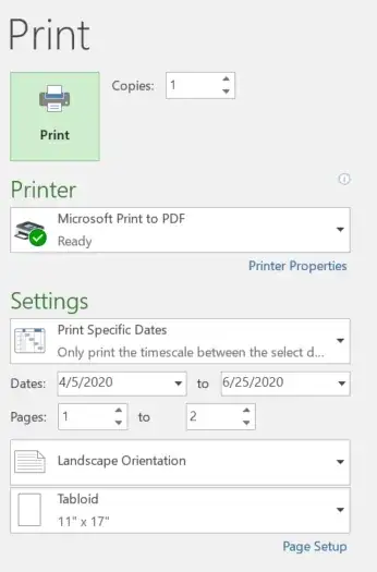

I really struggled with this problem and was very frustrated with the options for formatting when exporting to a PDF. But I have made the most progress when using the "Page Setup" options available when Printing to PDF.
page setup button
If I set the paper size to something very large, then it will fit a lot more on the page and in a more convenient layout. You can also specify how many pages wide and tall you would like the final document to be so that it doesn't spread out into that ridiculous grid mentioned above. You also have options to hide the legend and show more or fewer of the columns.
