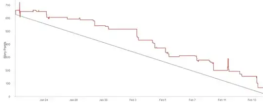

Patrick, let me tell you very briefly how Jira manages this. Why? Because I believe it is the right way to handle it :)
In Jira you start the sprint explicitly. Once it is started, all changes to the sprint in regards to content leads to a changed sprint scope, either increased or decreased.
In your case - starting off with 200 hours and then adding 18 hours will never give you an "updated" start point of the burn down (e.g. 200 hours + 18 hours) because these are considered as a change to sprint scope.
What you will see is that the burn down get a spike equal to 18 hours on that day and, if burned down the same day, you will also burn down those same hours (see below around feb 12).
In theory (and our practice), if you start off with 100 hours because that is your capacity, and you suddenly find 50 more, you cannot just add them into the sprint. Because you do not have the capacity (unless you initiate lots of OT). If those newly found 50 hours must be done in the sprint you should remove another set of 50 hours because those hours are not what your team initially committed to (they commit to 100 hours, not 150).
I would say that the TFS burndown is wrong. But because it doesn't show the spike as Jira does, not because it doesn't increase/update the additional work added during the sprint.
