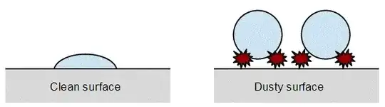

I have observed this as well, and experiment suggests it's because the dust is hydrophobic. If you splash a small amount of water gently onto the dusty surface you will see the water roll up to form beads that do not wet the surface. This is my rather crude attempt to illustrate what happens when you try and wet the dusty surface:
Dust
The brown splodges are supposed to be the dust. because the water/dust interface has a high contact angle the water droplets cannot get to the surface underneath to wet it. Hence it's difficult to wash the dust off the surface. You should find that if you use a detergent solution rather than just water the dust will wash off the surface.
