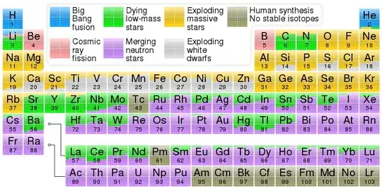

Second, there is a difference between the formation of atoms and the formation of nuclei. The quote you give is about the formation of atoms, but the image you show is about the formation of nuclei.

I think your question is also asking about nucleosynthesis. This story is quite involved; here I will just try to summarize a few of the main points.
First, BBN took place over the course of about 3 minutes (hence Weinberg's famous book, "The First Three Minutes"); it begins when free neutrons and protons can form, and ends when the rate of nuclear reactions becomes negligibly small. This timescale is set by the Universe's expansion rate; as the Universe expands, it cools, and over the course of three minutes it cools enough that nuclear fusion processes are no longer thermodynamically favorable. The time scale is crucial; BBN reaches several "bottleneck" processes which are very rare, and so have a very small rate, that essentially stop BBN from producing nuclei heavier than Lithium. On the other hand a main sequence star's lifetime is about 10 billion years. So there is much more time for nucleosynthesis to occur, and generate heavier elements, than in BBN.
Second, the conditions of BBN and stellar nucleosynthesis are quite different. At the start of BBN, the Universe consisted of a gas of protons and neutrons that had to fuse into Hydrogen, and work up to heavier elements one step at a time. Meanwhile, there have been a few (2-3) generations of stars; each generation undergoes nuclear fusion and populates the interstellar medium with heavy elements. These heavy elements in turn fuse future generations of stars, which are not "starting from scratch".
Finally, even in stellar nucleosynthesis, there is an upper limit on what fusion can do. Nuclei heaver than iron have a lower binding energy than iron, and so in thermal equilibrium will tend to disassociate and become iron. Therefore, non-equilibrium processes need to come into play to generate nuclei heavier than iron. This is the role of the $s$-process and $r$-process I mentioned earlier. In a violent event such as a supernova or a neutron star merger, nuclei that are ejected with very high energies will fuse, form stable heavy nuclei, and leave the cataclysm from whence they came to be distributed safely in the cosmos. These processes are responsible for the elements colored purple, green, and yellow on your chart.
To summarize:
  • BBN takes place approximately 10 seconds to 3 minutes after the big bang, and takes the free protons and neutrons from the early Universe and converts them into Hydrogen and Helium nuclei, with some trace amounts of nuclei as heavy as Lithium.
  • Recombination takes place much later, when the Universe is about 380,000 years old, and refers to the process where Hydrogen atoms are able to form, because the Universe has cooled to the point where photons in the cosmic soup do not have enough energy to ionize Hydrogen.
  • Stellar nucleosynthesis, over several generations of stars, takes the primordial Hydrogen and Helium and produces heavier nuclei, up to Iron.
  • Non-equilibrium neutron capture processes, such as the $s$-process and $r$-process, take place in cataclysmic events like supernovae and neutron star mergers, and are responsible for producing nuclei heavier than iron.
