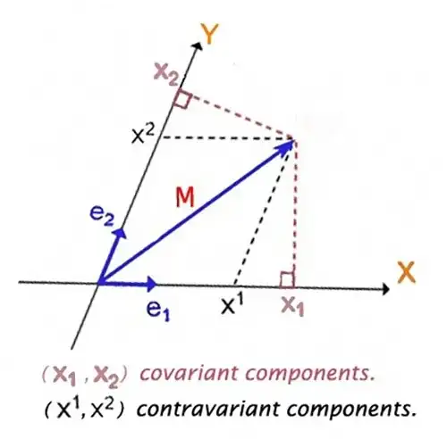

The following question is: if you have oblique vectors that are not at right angles, how do you represent vector coordinates? Do you pick ones that result from parallel lines to the tip of the vector, or do you take the ones that result in right angles from the tip of the vector
- The answer is: both work. This naturally introduces the concept of covariance, contravariance and dual space.
- And this also introduces a new problem: if the basis vectors are oblique, you cannot use the Pythagorean theorem to calculate the length of the vector, so how do you calculate it? And the answer is that you don't sum the square of the components, but you sum the products of the covariant and contravariant components. That is, from the image above, length of M is $\sqrt{x^1 x_1 + x^2 x_2}$
- Finally, we get to the tensors. It is clear that an orthonormal basis is just a very special case, where the general case can be an oblique basis with non-unitary vectors. "Regular vector notation" is simply not enough to represent and operate on all the quantities that you need to manage to make calculations on vector spaces. Given a vector, you need to be able to specify both the covariant components and the contravariant components to calculate quantities such as velocity etc. Tensors offer you the possibility to do exactly that: to have an object that can carry information about both covariant AND contravariant components, and it allows you to express concisely quantities like the vector's length etc. Obviously, in an orthonormal basis the covariant and contravariant coordinate coincide, and hence a vector is enough to manage them.
