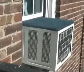

I saw a similar effect years ago and looked out the window to find that sunlight was reflecting off of a puddle of water on top of a slightly concave top panel of the AC unit. Either somebody set something heavy on it to try to stop noisy vibrations, or sat on it, or it perhaps deformed over time for other reasons.
These normally have a matte finish, AC window units are not normally shiny polished metal that can reflect so nicely.
So I suspect there is a puddle of water on top of a slightly concave metal panel, and we are seeing caustic effects from Fresnel reflections from ripples on the water induced by wind blowing or AC compressor vibrations.

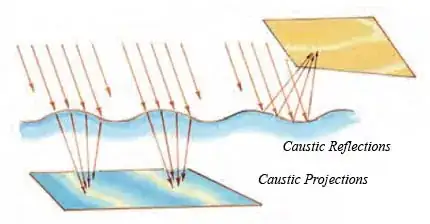

From James Gurney's blogpost Caustic Reflections
From James Gurney's blogpost Caustic Reflections http://gurneyjourney.blogspot.com/2010/07/caustic-reflections.html From James Gurney's blogpost Caustic Reflections http://gurneyjourney.blogspot.com/2010/07/caustic-reflections.html

Concave AC unit top with matte finish: These don't reflect by themselves, there's probably water on top.
https://www.shutterstock.com/image-photo/old-air-conditioner-installed-on-window-1079882936
Source: Shutterstock

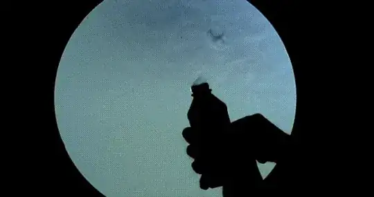

It might be the schlieren effect, which would concur with the effect being lessened when your blinds are more open. Basically when the light is partially blocked, in your case by your blinds, you see the movement of the air streams, the hot and the gold air moving around causing turbulence.
Wikipedia says
Schlieren flow visualization is based on the deflection of light by a refractive index gradient[4] The index gradient is directly related to flow density gradient. The deflected light is compared to undeflected light at a viewing screen. The undisturbed light is partially blocked by a knife edge. The light that is deflected toward or away from the knife edge produces a shadow pattern depending upon whether it was previously blocked or unblocked. This shadow pattern is a light-intensity representation of the expansions (low density regions) and compressions (high density regions) which characterize the flow.
Showing schlieren effect
