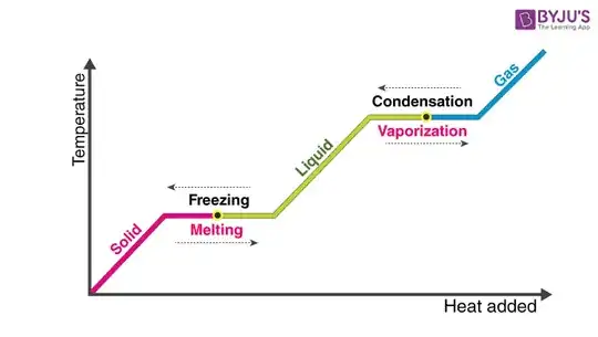

The temperature is really just the inner energy, or the mean velocity of particles. When we do work to the material, its inner energy changes. In most cases, the temperature changes linearily with the inner energy. But when we want water to evaporate, we need to do even more work to go across the boiling point because it needs to escape gravity. So, we need to give even more energy for water to evaporate. Same is with the freezing point. It looks like this on graph:
And here comes the answer to your question: ice can be colder than 0 °C. It just so happens, that the water molecules get packed together tightly at 0 °C (we call this ice), but this doesn't prohibite it from colding even more because the molecules in ice still vibrate with some velocity. We said that temperature is just inner energy, or the mean velocity of the particle. At lower temperature the particles move slower and they can (theoretically) reach the velocity of 0. This happens at around –273.15 °C, so the ice can get cold to this temperature.
About second question: it depends on definition of water. My definition is: water is ice, liquid water and steam. So water can get hotter than 100 °C. But this isn't liquid water anymore, it is steam. When liquid water reaches 100 °C, we "rename" it to steam. So, you are partially right, because liquid water needs to wait to achieve enough heat (graph above) to go over the boiling point to steam. And yes, steam can be hotter than 100°C.

Could you also please explain, whether the temperature of water can increase more than its boiling point? (Which is the second part of my question) can water be over 100 degrees Celsius? I most sincerely appreciate your response – Shahzad Rahim May 07 '21 at 11:50
1@ShahzadRahim Normal pure liquid water in a cup at normal pressure cant be heated over 100°C since it will go through a phase transition at that point. But the water vapor after the phase transition can be heated over 100°C. This is shown in the graphic as well. But this figure is just a slice of a higher dimensional graph since pressure is another variable on which the properties like the boiling point, depends. At higher pressure your water will start to boil at a higher temperature and the liquid phase can be hotter than 100°C before it starts to boil. – Hans Wurst May 07 '21 at 13:25
