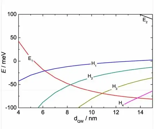

Now, there were several (experimental) advantages in creating a CdTe/HgTe/CdTe quantum well. First of all, since it’s a quantum well you would have sub-bands (not bands unlike bulk materials) due to quantum confinement in the out-of-plane (say $z$) direction. As a result, a single band in the bulk will split up into several sub-bands, each corresponding to a different quantized $k_z$, as you shrink the thickness of the material in the $z$-direction. Now, you can notice (in the figure below), unlike the bulk, the electron (conduction) and hole (valence) sub-bands do have an energy gap.
This plot obviously shows the minima (electron) or maxima (hole) of these sub-bands; they still disperse in k-space. And as you may know the inversion of the sub-bands will occur when you cross the critical thickness (as shown in the figure below).
