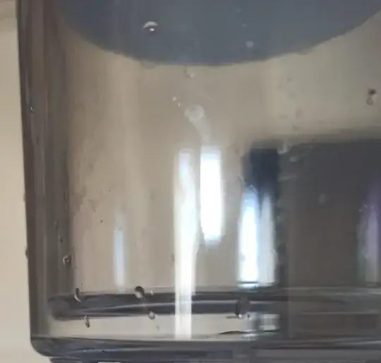

I have several thermal mugs, two of them by the same brand, have the same look, shape and size except that one is in steel (inside and outside) and the other one, plastic. Both have an insulating layer of air or vacuum.
I do not need a thermometer to tell me that the steel one is much better at keeping liquids cool/hot than the plastic one. With water near 90°C inside the mugs, I cannot feel any heat by placing my hand on the steel one (same as a thermos), while the plastic one feels almost like burning.
However steels conducts heat much better than plastic (about one order of magnitude greater thermal conductivity). Therefore intuition tells me that a metallic mug should be less efficient than a plastic one to keep things cool/hot, but the reverse seems true!
What am I missing?
I am adding pictures of the two mugs. On the transparent one, we can see the insulating gap. I think it is an enclosed volume so there shouldn't be any air transfer between it and the surroundings. Transparent mug close up.

  • I see. The gap is about 5mm at the bottom and less on the sides. My quick calculations indicate that conduction through the air might be bigger than radiation even at high temperatures. I wonder one thing though, is this air at 1 atm or less? How is the thermal conductivity affected if it is less than 1 atm? – untreated_paramediensis_karnik Jun 01 '20 at 13:11
