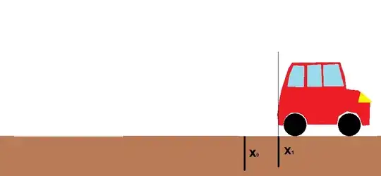

Imagine you have a pull back toy car. Its back part is on $x_0$. You push it down and move it in the back direction to the point $y$ (not marked): car1
Then you leave the car to move away: car2
Then you mark the final position by $x_1$: car3 Let's say, that the distance you have pushed the car is $d_1$ and the distance the car has travelled is $d_2$.
As you can see, the car has travelled more than before (same as $d_1 < d_2$). If you don't believe it, try it yourself. Why has that happened? The law of conservation of the energy tells us, that energy can't be created out of anything.
