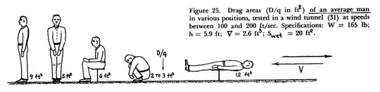

This being Physics SE, we should run some numbers. Below you see the drag force of a typical human being in different postures. This is from Sighard Hoerner's book "Fluid Dynamic Drag", page 3-14
Drag areas of a typical human in different postures
Running would be best approximated by the standing human; let's assume his drag area is a bit below those 9 ft². Drag area is the drag force divided by dynamic pressure. In case of a 30 m/s headwind the dynamic pressure in standard atmospheric conditions (air density 1.225 kg/m³) is 550 N/m². With a drag area of 8 ft² the drag force on that average human is 410 N or more than half his weight. Just standing in that breeze would require to lean forward by more than 30° (which reduces the drag area a bit). Running would only be possible if the friction between shoes and train roof would allow to transmit this horizontal force of 410 N - with one foot lifted up!
