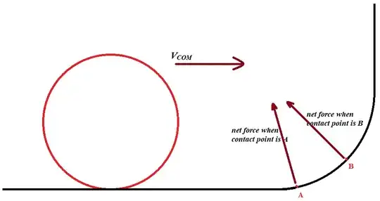

The ball will rise up the curve if it's horizontal velocity is not stopped or reversed. It's because if it's horizontal velocity becomes $0$ it won't be able to proceed further to climb up because of gravity. It might just for a while if the initial velocity is sufficient.
First case
Here, as you mention, it won't climb up because as soon as it hits the wall the ball will receive a force in the opposite direction (assuming elastic collision). Moreover it won't receive any net force in the vertical direction because the radius of curvature of the wall is smaller than that of the ball.
Second case
In this case, the ball will rise up because it's kind of an incline which is varying it's slope. Moreover since in this case the ball doesn't lose all its velocity in the $x$ direction at once it can move above the curve until all its potential energy is converted into kinetic energy.
Third case
Here, the ball will receive a net force which will be above the floor in the $-x$ direction as shown in the diagram. Now this force could raise the ball up but it may not be able to do so because of gravity. If there were no gravity the ball would go up and to the left.
