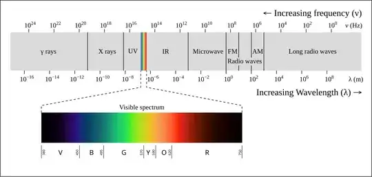

If you look at the electromagnetic spectrum,
EM-Spec
red light has a wavelength of about 600 to 700nm, your antenna will have $$L\approx 300nm$$ which is incredibly small. This is the reason, antennas in optical frequencies are subject to current research, see e.g. Resonant Optical Antennas by Mühlschlegel et al.
So, from this point of view it seems very unlikely that a Layman will be able to produce an antenna that can emit light at optical frequencies.
