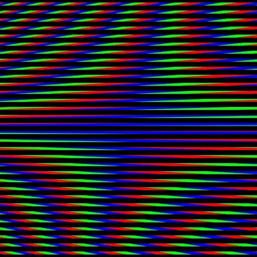

Here is a picture of rgb scanlines, and another picture of a pixel grid. Only one of the pictures needs to be perspective-warped with respect to the other, so I chose to warp only the rgb scanlines. I chose the warp in such a way as to recreate roughly the same arrangement as in the photo: that is,
  • the top half of the picture has rgb scanlines sloping slightly upward with respect to the pixel rows, the bottom half has them sloping slightly downward.
  • the left half-or-so of the picture has pixel rows spaced more widely than the rgb scanlines, and the right half-or-so has them spaced more tightly.
  • the vertical-ish line that we expect to manifest as the vertical-ish axis of the saddle is not exactly vertical, to keep it interesting.
When we overlay the two pictures, the saddle appears, as expected: pixel grid overlaid on rgb scanlines
Inspection of the combined picture gives me a sense of why the contour lines have to go the way they do, including the saddle shape showing where the two lines-of-reversal-of-behavior intersect. The horizontal axis of the saddle is where the horizontal-ish lines of the two grids have the same slope, and the vertical-ish axis of the saddle is where the horizontal-ish lines of the two grids have the same spacing.

Notice that the same kind of saddle shape appears in the contour curves of mathematical functions such as $z = x y$; these saddle-shaped contour lines are hyperbolas. The saddle shapes we see here are perspective warps of the contours of $z = x y$; therefore they too are hyperbolas (or other conic sections such as parabolas or elliptical arcs or circular arcs, but I don't see how those could manifest here).
In summary, saddle shapes (more specifically, hyperbolas) are what you get as colored contour lines of interference when a rectangular grid of pixels is overlayed on a picture of rgb scanlines such that the correspondence between the two pictures is a perspective warp, as is the case when you take a photograph of your computer screen with your phone.
