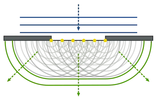

With diffraction (using the single slit experiment for simplicity), the wave is partially absorbed and partially transmitted. The form of the transmitted wave is not the same as the original, due to interference caused by the new wavelets, emitted at each point of the wavefront.
Huygens–Fresnel principle diffraction photo
The transmitted part does not interact with any particles (I'm ignoring atmospheric particles), so from a physical perspective, what are these emitters (at each point of the wavefront/the yellow dots in the image above)? And what causes them to emit new wavelets?

I think your confusion centers on the idea of "emitters". Huygens' principle does not require actual emitters; it simply states that each point on the wavefront acts like a new spherical wavefront emitter, and wavefronts downstream act as if they are the linear sum of the wavefronts emitted by those imaginary upstream emitters. Light propagating in free space without any obstacles obeys Huygens' principle.
If a wavefront is blocked anywhere by a mask with a pinhole aperture slightly bigger than a wavelength of the blocked wave, a very nearly spherical wave emerges on the downstream side of the aperture. That observation is the foundation of Huygens' principle. It really does not matter what the mask is made of.

You are completely right. The light interacts with the electrons in the screen. If the screen is completely closed, this generates an induced wave that is opposite in phase with the incident wave, so that the sum is darkness (a shadow).
When there is only a small obstruction (a hair or a thin copper wire), this will create a diffraction pattern according to Huygens principle, with the points in the wire as emitters for the induced field.
Now there is Babinet's principle. A wire is the complement of a screen with a slit. The induced fields of these are opposite in phase, but otherwise identical.
So the standard treatment of the slit is a shortcut. It is not practical to do the integrals to infinity of the screen from the edges of the the slit. Babinet tells us that one gets the same intensity profile.
