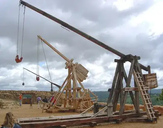

Inspired by this xkcd, which calculated the energy requirements for accelerating individual humans to escape velocity (regardless of consideration for what that would do to your organs), I am interested to know if a trebuchet (or catapult) could be built that could launch things out off the Earth. Escape velocity isn't necessary, as I'd consider a stable orbit 'off earth'.
  1. What would be some design considerations / challenges? Do we have materials that could withstand this type of force?
  2. What would be maximum weight limits, ignoring air resistance (a tennis ball? a human? a satellite? a human in a metal survival pod?)
  3. What would be the speed at which these objects would need to reach at the earth's surface to be into a stable orbital velocity by the time they exit the atmosphere? (factoring gravitational slowdown and air resistance)
  4. Is it ever conceivable that we could 'launch' supplies to the ISS or orbit this way? What about launching satellites like this?
Edit
I misspoke when I said catapult, a string tension driven device. I meant a trebuchet, a gravity-powered heavy-object thrower. QuickLaunch, Inc. has plans to do just this launching a SSTO rocket at 6 km/s, which then fires after launch and provides the necessary correction for orbital insertion. Basically, I just need a trebuchet that will accelerate a mass (they're trying 1kg, 10kg, 50kg and 500kg masses) to 6 km/s at launch.
Trebuchet

  3. The last problem that will make this Trebuchet impossible is the mass and required strength of the arm that will connect the heavy weight to the pivot point to the satellite. I suspect that making this arm strong enough will make it too heavy to work. So, for now let's assume the arm has zero mass and infinite strength. Then if we assume the heavy weight falls in say, about 1 second at about 1G, then to get the satellite to 17,000 miles per hour, the acceleration of the satellite would have to be 25,000 ft/sec^2 which means it would accelerate at 780Gs (so humans would be killed for sure). That would mean that the length of the arm to the satellite would have to be 780 times longer than the short arm to the heavy weight. So if the short arm were 10 feet, the long arm would have to be 7,800 feet which is 1.5 miles. I think you can see that the arm requirements would make this totally impractical if not impossible. For this to even work, the heavy weight would have to be greater than mass of the satellite times the long arm length divided by the short arm length by a very large factor (to insure the heavy weight falls at about 1G). If we assume a 100kg satellite, then in this case that means the heavy weight would have to be something like 10 or 100 times (7800/10)*100 kg - thus something like 780,000kg to 7,800,000kg. Imagine the strength of the arm that is required. Then think about how heavy the arm would be and how that would make all of these requirements even more impossible since a heavy arm would greatly decrease the acceleration of the satellite.

Edit: Okay... A trebuchet consists of two arms - Projectile arm and Main weight arm. The ratio of the length of the main weight arm to the length of the projectile arm is typically between 1/2 and 1/5. The main weight arm has the counter-weight required to shoot the projectile and it should always be in multiples of the projectile weight (The height of main weight arms also matters here). The angle we use commonly for a projectile is 45°. Here to attain the escape velocity (at least close to), you must use at least a million ton counter weight, a 10 lbs projectile, and a trebuchet more than 2 mile long, and use an angle of 90° would be helpful..! Theoretically possible I would say...
