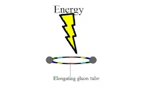

Gluon Color Confinement
This goes further. Gluons carry a property called color. When two quarks share a pair of gluons, the gluon interaction is color constrained. This means that as the quarks are brought apart, the 'color field' between them increases in strength linearly. As a result, they require an ever increasing amount of energy to be pulled apart from each other. Compare this to the EM force. When you try to pull an electron from its atom, it requires enough energy to be plucked from its shell into the vacuum. If you don't, it'll jump up one or more energy levels, then fall back to its original shell and release a photon that carries the difference.
Similarly, if you want to pluck an object from a planet, you need to provide it with enough energy to escape the planet's gravity indefinitely (energy needed to reach escape velocity). Unlike the gravitational force and the electromagnetic force, the force binding gluons to each other grows stronger as they grow apart. As a result, there comes an inevitable point where the it becomes increasingly more energetically favorable for a quark-antiquark pair to be produced than for the gluons to be pulled further. When this occurs, the quark and antiquark bind to the 2 quarks that were being pulled apart, and the gluons that were binding them are now binding the new pair of quarks.
Color Confinement
This animation is from Wikipedia, courtesy of user Manishearth under the Creative Commons Attribution-Share Alike 3.0 Unported license.
But wait! Where did those two quarks came from? Recall how pulling the quarks apart requires energy? Well that energy is on the scale of $\mathrm{GeV}$. At these scales, the energy may convert to particles with kinetic energy. In fact in particle accelerators, we typically see jets of color neutral particles (mesons and baryons) clustered together instead of individual quarks. This process is called hadronization but is also referred to as fragmentation or string breaking depending on the context or year. Finally I must point out that this one of the least understood processes in particle physics because we cannot study or observe gluons alone.
