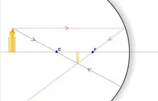

Here is the appropriate ray diagram.
What you will notice is that the image is distorted and this is because the spoon does not have a spherical (actually parabolic) shape and so produces lots of distortion (aberrations).
You will note that the image is formed behind the spoon and so is called a virtual image - one that cannot be projected onto a screen.

Now turn the spoon over so that it is boring away from you and so acting like a convex lens.
You will see an inverted and diminished image of yourself which appears to be in the mirror.
It is not.
It is actually a real image which you a focussing on and it is in front of the mirror.
Just because there is no screen there does not mean that the image does not exist.
The image is there in space and your eye can collect the diverging rays from that image and focus them on the retina.
