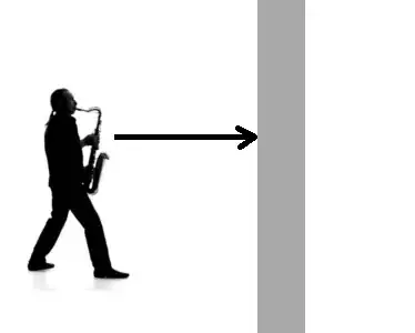

Still, the music room example is relatively simple. Let's assume the wave coming from the instrument hits the (non-porous) concrete wall perpendicularly:
And you're standing on the right-hand side.
Physical properties of the wall - generally it's mass, $m$, and stiffness, $\kappa$, determine which frequencies are transmitted (to you) and which frequencies are reflected back (to the music room.)
