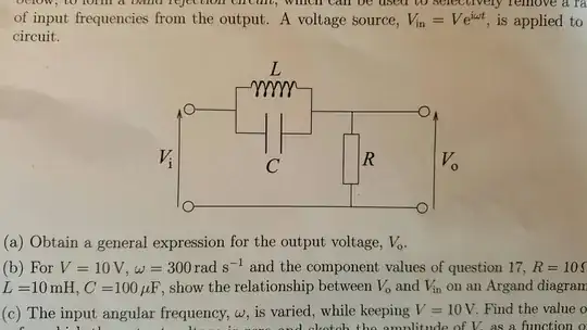

I have now come across slightly different circuits which do not have the inductor and capacitor and resistor in series. Two examples are below
My question is: do these circuits have a 'resonant frequency'? And if so, what does it mean for these circuits to be driven at their resonance frequency?
I have a guess for the second circuit, that the parallel capacitor/inductor circuit can undergo resonance when the driving frequency is equal to $\frac {1}{\sqrt {LC}} $, and then all the source voltage will be across this parallel portion in resonance and there will be no voltage across the resistor. The problem is, that would then mean that there is no current in the circuit! If there is no current in the circuit, surely there cannot be a voltage over the parallel combination?
I am trying to develop both an intuitive feel of what is physically going on in these circuits, and an understanding of how the mathematics relates to this. Any help would be much appreciated!

  • @sammygerbil this is a slightly different question as these are not 'typical' RLC cifcuits- I am struggling to see how these circuits could have the typical features of resonance. If I apply Kirchoffs voltage law, as I would in a typical RLC curcuit to find the differential equations giving the charge, then I do not get a differential equations of the same form in these examples. I don't get anything that looks like oscillatory motion at all. – Meep Jan 09 '17 at 23:43
  • What differential equations are you getting? – sammy gerbil Jan 11 '17 at 19:09
