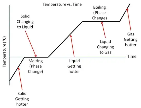

Sure, but that's easier said than done. If you had a magic iron that never loses heat, okay, but in real life the hot iron will heat up the air in the room (candle won't burn in vacuum), the hot air will float away, and in effect you will end up heating up the whole room because it's all in thermal contact. That's asking for a lot from a candle, but if you somehow had a candle with infinite fuel and had it burning indefinitely, then eventually you could heat the whole room above the melting point of iron (it has to be above because melting itself requires some heat input), and yes, it would melt - but we are now talking about a very extraordinary candle. Not to mention the mass of such a candle could act as a heatsink, or it could ignite in your firestorm of a room, so there is a whole host of practical problems.
So in conclusion, what kind of candle would it take to melt iron? You need:
- A fire hotter than 1500C.
- An insulated environment which can get to this temperature and stay there.
- A big enough candle to ensure that the rate of heat loss is always less than gain (remember that heat loss is faster when the temperature difference is larger).
This is kind of device is called a forge.
